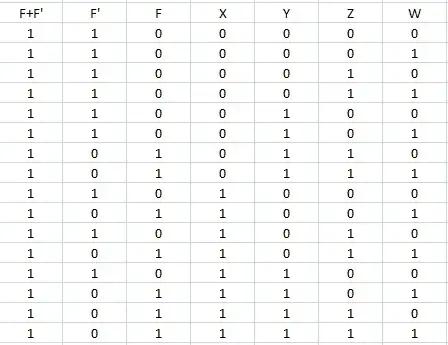

F + F' = 1 means that you have to show that no matter the state of the 4 inputs, OR'ing the result of those 2 always result in 1,
A few minutes in excel shows it is indeed the case. You can use "NOT()" to invert between 0 and 1 in excel.
F = W * X + Y * Z
F' = W' * Y' + W' * Z' + X' * Y' + X' * Z'
As to why this is the case, If you want F to be false, e.g. setting W and Y low, you just made F' true. If you make X and Z low, you also made F" true, same for swapping there pairs.
