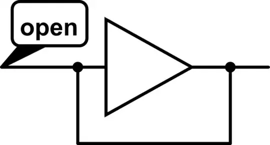

"Indeterminate" means that you do not know what the state is.
A JK latch will toggle its outputs with J=K=1, and you cannot exactly predict how much time each toggling takes, so the final state will indeed be unknown. Furthermore, it is possible that its internal control signals are faster than the output transistors can switch, so in that case, you might not even get a square wave, but an output signal that does not even reach valid logic levels.
Other ways get an indeterminate state are to
  • violate the setup/hold time requirements, so that you do not know whether some J/K input happens to be read as low or high when the clock is processed; or to
  • observe the initial state after power-up, before the flip-flop has been initialized (with asynchronous set/reset) or before some value has been clocked in.
    You can get the same effect with a simpler circuit, like the buffer below: the output state is either high or low, but you don't know which one:

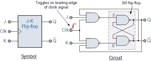

Can we call output of a level-triggered JK flip flop (with clock duration more than flip flop delay) to be indeterminate when J=K=1? I know this corresponds to toggle state, but due to race around condition, can we call it indeterminate?
Answer: No
When J=K=Clk=1, the S!,R! Intermediate states will toggle to complement the output states of Q,Q!.
  • The latched SR state of S!=R!=0 is not possible.
  • The State of a latch with S!=R! =0 is not indeterminate as both Q,Q!=1.
    • the unknown in a simple latch is which SR input changes 1st, from above, that determines which output of Q,Q! Changes from 11 to either 10 or 01.
    • but this does not occur in a JK FF. enter image description here
