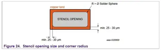

With any paste soldering if you don't have the right solder and the correct amount, you'll get bridges. If you clean off the pads well, and use a good process then you won't get bridges. You apply the correct amount with the right sized stencil, and must be sized around the pads. Use the recommended stencil pattern and thickness:
The thickness of the stencil determines the amount of solder paste deposited onto theprinted circuit board land pattern. Due to the fine pitch and small terminal geometryused, care must be taken when printing the solder paste on to the PCB. Typical stencil thicknesses are given in Table 3
Since QFN/SON are (most likely) not the only package on the actual production PCB,the recommended stencil thickness for the other packages may be thicker than desired.For such a case, a step-down stencil is recommended, where most of the stencil for thePCB has a typical thickness, but the area for the QFN/SON would be reduced to 100 to150 μm, depending on the package pitch.
The dimension of the stencil openings should be a minimum 25 to 30 μm (5 to 10 %)smaller than the size of the corresponding copper lands to account for alignment and PCB tolerances. A fillet at the corners reduces the adhesion to the solder paste and improves the paste release (Figure 24). The fillet radius depends on the solder pastetype; i.e. it should be larger than the diameter of the solder spheres.
A minimum aperture size is needed to ensure the proper release of the solder paste during stencil printing (Figure 24). The area ratio and the aspect ratio between stencil opening and stencil thickness are used to determine the minimum dimensions,respectively.
Source: https://www.nxp.com/docs/en/application-note/AN1902.pdf
