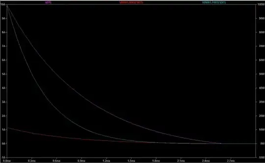

Edit: (below is a simulation of 1mH inductance with 1 ohm series resistance and 10A rectifier, shortly after 10A current is switched off)
Pink trace is diode current, cyan trace is power in the coil resistance, red trace is power in the diode. Force of a solenoid will be more-or-less proportional to the coil (and thus diode) current (pink trace).
Integrated energy for the rectifier: 7.7681mJ Integrated energy for the coil: 41.844mJ
As a check, the total energy stored in the magnetic field is obviously 50mJ, and the two add up to 49.6mJ, pretty close. I've used a real MOSFET model for the switch
By comparison if you remove the diode and add a 36V zener across the transistor, the current drops to zero in about 350us rather than 2.5ms, a 7:1 improvement, but the zener sees a peak power of 360W and absorbs most of the stored energy.
