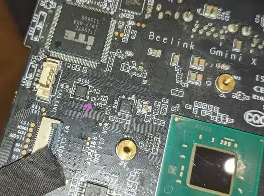

Well, I finally fixed the issue. As was correctly stated by @ChrisStratton in a comment this was not the original failure. The short from 12V to ground persisted, but the replaced mosfet did not blow as I connected the device to a current limited PSU, limited to 12V@0.15A, it did get toasty warm. I finally tracked it down to a faulty ceramic capacitor (or perhaps it was promoted to a 0R bridge resistor!).
Removing that sucker fixed everything up and now it is booting back up! Seems it purpose was just a capacitor bank, but still need to replace it, for now the device runs without it. As for the value, no idea, I'll probably just add a beefy cap (1uF).
The bloody fuse still works, YOU HAD ONE JOB TO DO FUSE!
Was fun to learn to do to SMD rework, always wanted to do it but never found an excuse :) Luckily the board and components were small enough not to require PCB heater...
For posteriorities sake, in hopes it helps someone else, the faulty capacitor was found between Q168 and Q171 as shown in the bellow image (capacitor is already removed).
Removed capacitor
