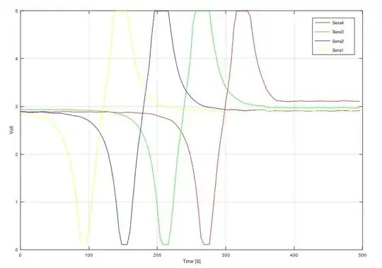

I'm trying to find a robust solution to linearize four hall effect sensors outout to obtain a signal that I can use in a PID control scheme.
The output data is collect via 4 ADC channels on an ATmega328p chip (Arduino) by sliding a magnet with the south pole first, perpendicular across the sensors with a fixed velocity and distance enter image description here

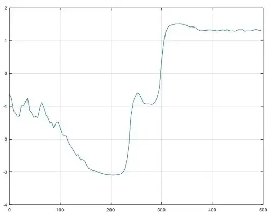

The result is, very very poor :) Mostly because the sensors aren't spaced exactly 90 deg. but I would expect to see something that doesn't look like this and more in the style of what's refered to in the application note.
Atan2 output
I'd love to end up with a nice curve, I can curve fit and feed into my control system? But how would you go about linearizing this signal, am I missing something?

  • you can start off by moving the magnet further away so they don't clip at max field, if it is indeed the Halls clipping. If they're still linear, then attenuating the signal into the ADCs. It won't solve the problem, but throwing away data at the start of the process is a good way to make it even worse. – Neil_UK Aug 27 '19 at 12:57
  • But the sensor outputs not nearly have sine wave like outputs, to use then atan2(), they are saturated also. You have to move the magnets away, as stated in the app note. – Marko Buršič Aug 27 '19 at 12:57

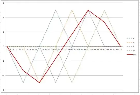

Please check again application note! in this way the output overlap is very important! i thinks you must install the sensor closer than now ! please see this picture from application note.
Sensor output
I make simple result in excel File
please pay attention to this result it is output formula out = (4 * avgADC0 + 6 * avgADC1 + 6 * avgADC2 + 4 * avgADC3)/6
it is 75% overlap
75% overlap
it is 20% overlap
20% overlap
As Mahdi KhosroAnjom pointed out, there is a region in each curve where the output is fairly linear with position. If the sensors are spaced properly, then you will always have one of those regions to use. The way that your sensors are spaced, there are positions where none of the sensors are in a linear region. I've used arrays of Hall sensors in this way, but you still run into the problem of deciding which sensor is the right one to use.
