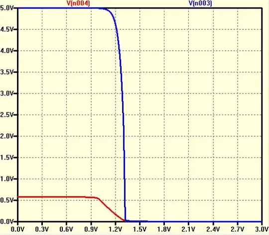

The circuit shown below is implemented using two AO3400 N-MOSFETs.
AO4300 datasheet here.
The right-hand MOSFET is connected with normal polarity (Vds is positive),
while the left-hand MOSFET is connected with reverse polarity (Vds is negative).
The graph at below right shows the relationship between Vgs and Vds simulated by LTSpice.
The blue curve is for the normally connected FET, and
the orange curve is for the reverse connected FET.
At low Vgs (<< Vgs(th)), the reverse connected MOSFET is conducting due to current in the body diode, resulting in a Vds value of about 0.6 V. As Vgs increases to above 0.4V , Vds starts towards GND level.
Why does the reverse connected MOSFET starts to turn on from about Vgs = 0.4 V when this MOSFET has about 1.1 V threshold?

Your device behaviour for comparison.
If the device behaved symmetrically you would expect the 'yellowish' body diode limited curve to extend out until about Vgs(th)_forward at about Vgs = 0.6V

  • @Sano ... Note that The reverse FET curve that you posted shows Vds of about 0.2V at Vgs = 1V. This means that V across 100 Ohms is (5-0.2) = 4.8V so Ids is about 4.8V/100 Ohms = 48 mA. This is far far far above Ids at Vgs(th) - so actual Vgs(th)_reverse must be much lower than 1V.. . The paper is EXTREMELY useful and answeres your question well. – Russell McMahon Aug 26 '19 at 09:49
  • So, in MOSFET we don't have the same situation as we have in BJT's when reverse biased? When now Vbc voltage will open and control the BJT? Because it looks like that now the Vgd voltage larger than Vth opens the MOSFET instead of Vgs? – G36 Aug 26 '19 at 14:15
  • The reverse connected MOSFET's Vgd-Vds red graph in G36's anwer ,looks representing the same drop down point and the same width between drop down point and GND reaching point compared with forward connected MOSFET's Vgs-Vds blue graph in the same figure. Is this coincidence? – ssa2 Aug 26 '19 at 16:32
  • Of course, if I plot Vgs -Vds in the simulation for the reverse connected MOSFET's I've got the same result Sano shows on his. – G36 Aug 26 '19 at 18:01

I use this one http://www.aosmd.com/products/mosfets/n-channel/AO3400
And get this results:

  • I know it, and it is written in my question. I want to know why reverse connected one is start to drop down Vds when Vgs is under Vth.(near 0.5V) – ssa2 Aug 25 '19 at 14:51
  • @Sano Until V2 voltage is lower than Vht the bod diode is ON and conduct current. Right? But at the time when V2 > Vth MOSFET normal (channel) current begins to flow. And MOSFET shorts out the diode current. – G36 Aug 25 '19 at 15:00
  • But Vds is start to drop down at 0.5V even though Vgs is far from Vth. – ssa2 Aug 25 '19 at 15:03
  • Do you have a MODEL for AO3400? – G36 Aug 25 '19 at 15:12
  • Yes. I got it from website – ssa2 Aug 25 '19 at 15:13
  • See my graph from LTspice. – G36 Aug 25 '19 at 15:16
  • I think it is Vgd-Vds graph, not Vgs-Vds. – ssa2 Aug 25 '19 at 15:25
  • Oh, this result represents MOSFET can be turned on by Vgd, not only by Vgs. Why? Source and Body is connected, so Vgs=Vgb then chanel is appear, but drain is not connected to body ,so Vgd can't apply voltage between gate and body. Why Vgd can turn on MOSFET? – ssa2 Aug 25 '19 at 15:30
  • >I think it is ... This is about the graph of reverse one. – ssa2 Aug 25 '19 at 15:58
