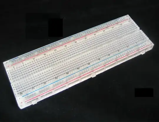

Adafruit has great prototyping stuff at very reasonable prices.
They have a really nifty clear breadboard that has power rails that snap off so that you can snap together multiple board for larger projects. And since it's clear you can see the junctions inside. Not that you would be able to tell from that if a junction was failing. But it's still pretty nifty.
clear breadboard

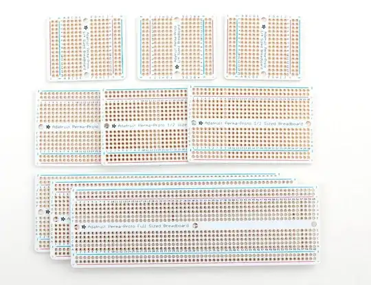

As others have mentioned, going to a pad-per-hole type board and using solder has many advantages. While somewhat impractical for course work where you'll be changing it up every week, they're great for personal projects. Or if you want to solidify a certain circuit you breadboarded for class to show the grandkids down the line. I still wish I had the ADC I build from discrete components in college on a breadboard.
In that vain, I highly recommend Adafruit's Perma-Proto boards. They are fantastic to work with. And since they have the same layout as a breadboard, transferring a circuit is very easy.
perma-proto
