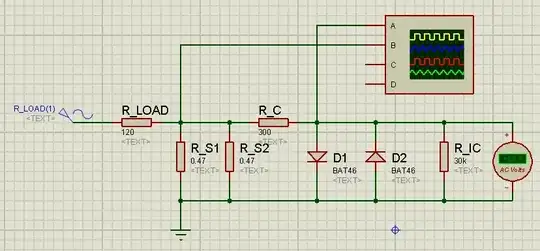

Here is my current schematic:
circuit schematic
Where:
  • R_IC is the IC's input pin impedance, according to its datasheet.
  • R_LOAD is the already mencioned variable load. In most circumstances, it will consume less than 1A peak, in another words, its "average" impedance will always be above 311 ohms. But I'm trying to avoid the range of the input pin to be exceeded in possible peaks (when the load is connected, for example).
Since I've asked the question last night, I kept searching for alternatives. I found a clipping circuit voltage in a Malvino and Bates' book. The difference compared to my original circuit is the presence of R_C resistor. The book says that its value should be somewhere around 1% of the load value (which in this case is R_IC).
I must say that the simulation result improved considerably with the presence of the R_C. And I think I understand its purpose: it is to "consume" the potential difference that exceeds the threshold that the diodes will establish. But still the established limit is not being respected.
results
I'm open to suggestions on how to ensure that the limit is obeyed with less "tolerance." But as I said, I need solutions that use simple components (diodes, transistors, op amps, etc).

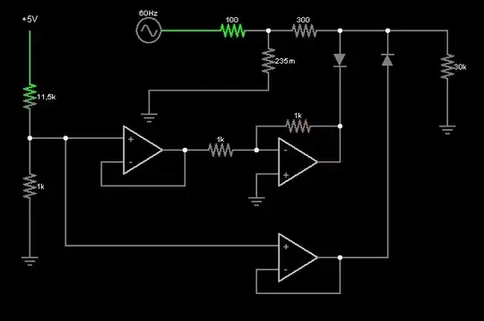

I looked for other solutions and I managed to assemble the following circuit:
circuit2
Now I'm using "normal" diodes (forward voltage about 0.6V). The first stage of opamps are to don't mess with equivalent resistance (I think this is officialy known as "impedance transformation"). The second opamp is to invert the bias.
This way I can "remove" voltage from the diodes and put them in short with less voltage.
As you can see, this apparently works (input on the left, output on the right):
results2

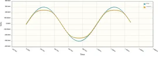

But when the input is below the threshold, the output is slightly lower than the input:
results2b
This isn't a real problem, but if I can avoid it, it would be better.
Now... the questions:
  • First of all, will this work?
  • I've used this simulator because it is very simple. But I didn't choose a opamp. The only opamp that I know is the 741. What opamps can you recommend to me?
  • About the diodes... 1N400x serves this purpose?
  • How can I make negative supply for all opamps?
  • How can I better calibrate the components values to get even closer to the threshold?

    Can you show the schematic of what you simulated? Schottky diodes should work in this situation, assuming you are not too fussy about exactly what voltage the clipping happens. – The Photon Oct 24 '12 at 21:50

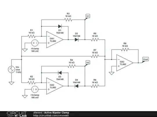

  • I've worked out a way to create an active precision clamp using a pair of precision rectifier circuits, as long as the bandwidth required isn't too great. It requires three opamps ... if you think it might be applicable, I'll write it up as an answer. – Dave Tweed Oct 24 '12 at 23:17

  • I can't speak to availability in your country, but Microsemi UPS115U has guaranteed max forward voltage of 220 mV at 1 A, and is "widely available" in the US (meaning, it's available at Digikey). Your BAT46 is likely to cause problems since it's only rated for 350 mA repetitive peak current or 150 mA continuous. – The Photon Oct 25 '12 at 04:40
  • @ThePhonon: I've edited my question. And about the UPS115U... I can't use it because it would take weeks to arrive in Recife/Brazil. – borges Oct 25 '12 at 15:03

  • Where is the voltage source in your schematic? What is the scale on your graph? – The Photon Oct 25 '12 at 15:41
  • @ThePhoton: the voltage source is the "probe" in the left of `R_LOAD`. The scale is 0.1V/div for both signals. – borges Oct 25 '12 at 15:44
  • @DaveTweed could you explain to me how to make the clamp using op-amps? – borges Oct 27 '12 at 01:08
  • In your op-amp circuit, the reference voltage is unstable because it includes whatever ripple and noise is in the +5V. The simplest thing to do is to put some big electrolytic cap in parallel with the 1K going to ground. Another way is to use a spare op-amp as a Sallen-Key low-pass filter to generate the reference voltage off that voltage divider. That can not only use smaller capacitors, but has second-order rolloff. – Kaz Oct 29 '12 at 17:17
Here's the active clamp circuit I came up with. I entered it into Circuitlab so that I could simulate it and verify its performance.
Whenever the input tries to swing beyond either clamping threshold, which are determined by the ±Vclamp sources in conjunction with the resistors, the corresponding precision rectifier produces a signal that offsets the overvoltage, holding the output constant at the clamping threshold. With the resistor values shown, the value of ±Vclamp needs to be 2/3 of the desired clamping level.
Note that if the thresholds are not symmetrical, the output will have a DC offset.
Note that the output is inverted relative to the input. This is required because the inverting input of OA3 needs to be a "virtual ground" for the mixing to work correctly. An inverting buffer can be added at the output if needed.
Note that R1, R2, R3 and R4 need to be the same value. Also, R5, R6, R7 and R8 need to be the same value, but not necessarily the same value as the first group. However, keep in mind that R5 and R6 affect the relationship between ±Vclamp and the actual clamping threshold. The 2/3 relationship only holds if all 8 resistors have the same value.
CircuitLab Schematic mvvek8

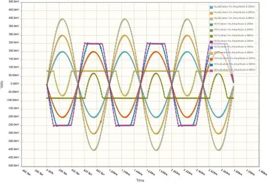

The following graph shows three input sinewaves of 200, 300 and 400 mV (blue, brown, gray, respectively) and the corresponding inverted output waves that are clamped to ±250 mV (red, blue and purple, respectively). I also show the waveforms for V1 and V2 for the 400 mV case (the two funky waveforms running across the middle).

Dave Tweed
