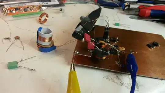

Prototype to give you some idea of the coil sizes. The ferrite is from a scrap brush, but there is one from Amidon that should work quite nicely. The innards of a scrapped brush is in the background to give you an idea of what the original pickup coil looks like.
prototype
