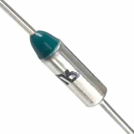

Since TCO defines the protection for electronic equipment and I would think 45'C and up could be available in this catagory, it may be that you need to look at Thermostats or thermo-coupled pressure switches or electronic switches using thermistors or solid state thermal sensors etc etc.
More details on your application could help define the unstated specs. Voltage, current, cycle lifetime, environmental rating, sealed, air/liquid, chemical compatibility etc.
If you are looking for say a 40'C inline TCO enter image description here, you you need to ride on some existing demand or have purchasing leverage to ask disti's or OEM's like Cantherm, Honeywell for a custom part for say 100K pc's a yr at 10 cents. (ballpark)
