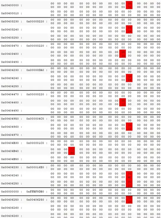

This picture is from a custom software which reads data and compares the read data to zero. The numbers in the third column are the number of bits which are not zeros from the read data.
What I can say is, that the first 60MBytes are error free and then the errors start.

Also, the errors are single bits and it can happen that a bit swaps back to zero and another in the same row changes to one.

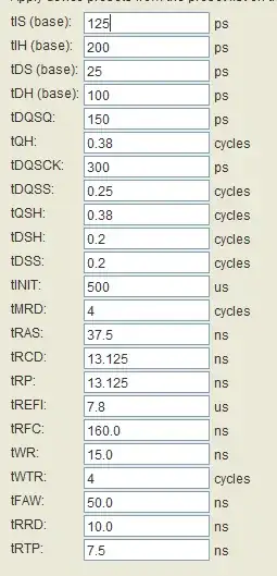

I tried various settings in the Uniphy IP Core (CAS settings and so on): From using ODT (Can't use dyn ODT because the Cyclone V FPGA is not able to use read leveling) to increasing CAS latency, to modifiying memory timing. I made a SI simulation, but wasn't able to eliminate the errors with adjusting slew rates tds, tdh, tlh and dls.
My current setting is, from the RAM side seen:
CAS latency : 5
Output drive strength : 40 Ohms impedance
No additive CAS
And memory Timing
