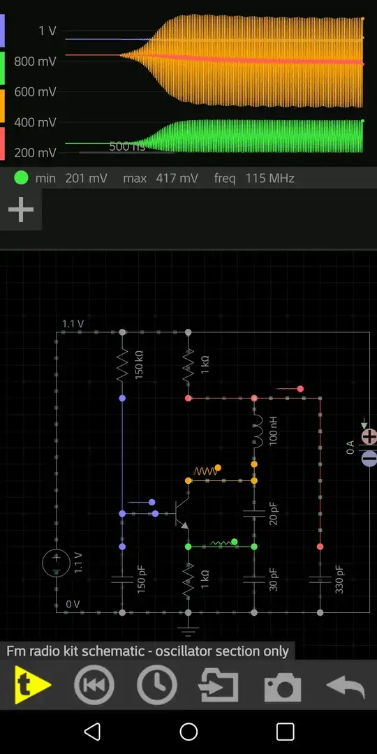

Simulation 2Simulation resultsI have built an FM radio receiver from a kit. I'm very happy with the results! It is the Sinclair Micro FM.

If I am doing my calculations correctly, it seems the collector of Q1 will sit at about 0.2v DC, the base at about 0.8v DC, and the emitter at about 0.1v DC. If this is correct, then the base/collector junction is forward biased. Again, if this is correct, I don't see how Q1 will amplify transient noise to begin and sustain oscillation. I also don't see how it can amplify incoming RF.
The only thought I can come up with is... incoming RF and transient noise should show up at the collector. This will affect the base to collector voltage. As the base collector junction is FORWARD biased, a small voltage change across this junction will induce an exponential current change. I am guessing this current change, maybe through the feedback capacitor from the collector to emitter, will act with regeneration and magnify the original voltage change at the collector? This seems unconventional, but I really want to understand how this circuit oscillates! When I run this circuit in a simulator, it indeed does oscillate!
Further, I am trying to understand how this circuit mixes the incoming RF with the LO. For this to happen, the two signals need to go though a non-linear circuit. At first I was told by the designer this circuit will run near cutoff. But I see this running in "saturation". Any ideas to clear this up for me?

  • Sadly when I simulate the autodyne stage (Q1), it indeed amplifies and oscillates and stabilizes as expected, however, I don't see Q1 going into cutoff. I see the opposite... hovering around saturation. So either something is unique about this circuit, or, I am not simulating the circuit correctly. When actually fabricated this circuit works and picks up many FM stations, so I am now just trying to understand the schematic and logic and electronics behind the working circuit. I am sure you can tell I am a novice, perhaps not knowing how to explain myself well... But thank you so much! – dhrovner Aug 22 '19 at 15:21
  • It could be that the transistor is, indeed, going into saturation rather than cutoff. That would have the effect of varying the gain within a cycle, which is what's necessary for mixing. Having the transistor saturate in an oscillator circuit like that tends to kill the Q of the resonator, which significantly reduces the radio performance, but things ought to still work. – TimWescott Aug 22 '19 at 15:45
  • Thanks! I've added a screenshot of my simulation results. – dhrovner Aug 22 '19 at 15:47
  • In the simulations I reduced the value of R2 to exaggerate the results. – dhrovner Aug 22 '19 at 15:53
