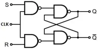

I know following variants of SR flip flop:
  1. Using NAND-NAND combination
  2. Using AND-NOR combination

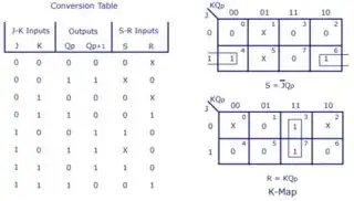

I was guessing how we can obtain JK flip flop for each of these variants. I found below approach showing how we can convert NAND-NAND SR flip flop in JK flip flop: enter image description here
So, by above approach, we are getting,
S = J'Q and R = KQ

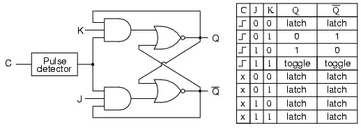

I searched online for correctness of this. Didnt found anything. Only found this page which shows JK flip flip using NOR-NOR gates as follows:
This flip flop comes with KQ and JQ' which definitely does not match with what I have got.

Found by experimenting with the mentioned logic simulator, but can be obtained by thinking, too.

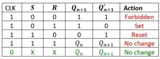

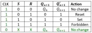

The table of the AND NOR flip flop seems wrong to me.
  1. When both S and R are 0 it's the same case as when CLK is 0 due to the ANDs. Therefore it can't be forbidden.
  2. There is a forbidden state change if S and R are both 1 and CLK changes from 1 to 0. The circuit starts to oscillate, therefore this must be forbidden. This is the same as for the other flip flop.
It should be equal to the table of the NAND NAND flip flop concerning the actions. But when both S and R are 1 and CLK is 1, the flip flops produce different values. The NAND NAND FF sets both Q and Q' on 1, the AND NOR FF sets both on 0.
You can use transformations from NAND to NOR to see why this has to be like this.
Using a pulse detector is a difficult thing, not to say dangerous. You can't be sure that the generated pulse is wide enough to meet the setup conditions for the following gates.
As I learned edge-triggered flip flops in the real world are built from two level-triggered flip flops with complementary level sensitivity. This is called "master-slave".
Lesson learned: Not every web site that looks instructive fulfils its promises.

  • The truth tables for the two RS flipflops should be identical assuming you keep the input labels to the two circuits as they are. The Nand/Nand table is correct as it is. –  Aug 22 '19 at 13:03
  • @James Thanks! That's right for "set" and "reset", I'll edit my answer. But for both on 1 both flip flops output different values. – the busybee Aug 22 '19 at 13:12
  • @busybee Yes agreed. Forbidden input state for both RS flipflops is with both inputs high. For Nand/Nand both inputs high gives both outputs high. For And/Nor both inputs high gives both outputs low. Got there in the end! Too late to edit my comment. –  Aug 22 '19 at 13:27
