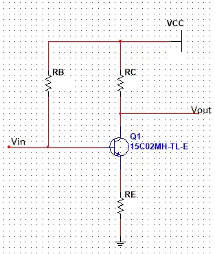

Here's the general DC equivalent for the CE amplifier I am working on:
I have looked at different CE amplifier circuit problems to help me solve this one and almost all of them have the voltage divider configuration at the base side of the transistor circuit. With this circuit, RC, Vcc, Beta, and RE have been given. RB is the resistor I need to solve for. My approach at the moment is using load line analysis. However, I am not sure if it is the correct way to solving this circuit.
The full circuit looks similar to this:
Please note that I have presented this in a general form because I just want to be steered to the right path of doing the calculations for this particular setup. I am not seeking a full answer, just a guide :)

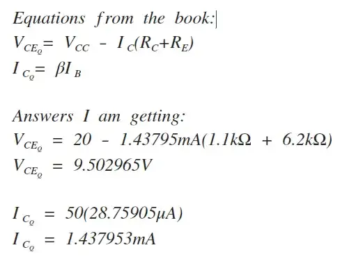

  • @TimWescott $$I_(base)=\frac{\frac{Vcc}{Rc}}{Beta}$$ – AugieJavax98 Aug 13 '19 at 15:14
  • @Andyaka That's how the problem is set out – AugieJavax98 Aug 13 '19 at 15:15
    Try calculating the base current you need to get the \$V_{out}\$ you want. Then calculate the base resistor you need. Then (and this should be the point of the lesson, although it may not come out until a later class) change the beta by a factor of two and see if your circuit still works. – TimWescott Aug 13 '19 at 16:01
  • @AugieJavax98 In active mode operation, \$\beta=\frac{I_\text{C}}{I_\text{B}}\$. Your method of computing \$I_\text{C}\$, show in comments, doesn't appear correct to me. Could you re-consider it? – jonk Aug 13 '19 at 17:32
  • @jonk Yea it is wrong. Load line analysis is probably what I have to do. – AugieJavax98 Aug 13 '19 at 18:10
  • @AugieJavax98 You could use algebra, as well. Why don't you disclose the values you do have? As Tim Wescott points up, this really isn't a good circuit in practice. It's hard to get a DC operating point that tolerates part variations because you aren't allowed to get an extra degree of design freedom using a resistor divider at the base. Do you have an idea of what you want for the quiescent emitter voltage and quiescent \$V_\text{CE}\$? – jonk Aug 13 '19 at 18:19
  • @jonk It's an exercise I am working on. So I have to pretty much calculate everything to suit the problem's needs. Oh, and I have added a picture of what the full circuit looks like on my post. I just want to get a general idea as to how I can solve for the base resistor in this scenario. If it was in the voltage divider configuration, It would've been a bit easier for me to work through. – AugieJavax98 Aug 13 '19 at 18:55
  • @AugieJavax98 Here is a [partial, quick list of links I've written](https://electronics.stackexchange.com/a/335128/38098) and also a [list of different BJT configurations and some important design thoughts](https://electronics.stackexchange.com/a/436341/38098), to start. None of these directly address your problem above. I can write something, I suppose. But you may want to refer to some of those to more fully gather up some reasoning (not all of which I'll include here.) – jonk Aug 13 '19 at 19:07
  • @AugieJavax98 Are you supposed to deal with the first schematic you show? Or the second? – jonk Aug 13 '19 at 19:13
  • @jonk The second schematic is the full circuit. The first schematic is just the DC equivalent of the full circuit (second schematic). I am doing a DC analysis so I am focusing on the first schematic. Oh and thanks for the links – AugieJavax98 Aug 13 '19 at 19:15
  • @augieJavax98...as an exercise, the circuit is OK. However, for practical realization the shown method to bias the transistor is NOT recommended (Horowitz/Hill, Art of Electronics: "Don´t do that"). The reason is as follows: The method is a mixture of current injection and voltage stabilization....this is a bad combination: The emitter resistor produces a feedback voltage, but at the base node you have not a fixed bias voltage but instead a beta-dependent base current. – LvW Aug 15 '19 at 06:55
  • @LvW yea it's just an exercise. But the fact that its impractical triggers me so much ahahaha. – AugieJavax98 Aug 19 '19 at 05:28
Start with applying Kirchhoff's voltage law on the path shown:
In this loop only base current is unknown. Find it. Next, apply kirchhoff's voltage law in this loop:
Use, Emitter Current=Collector Current=beta*base current. Find voltage between Collector and Emitter. If the final result satisfies that the transistor is in active region your answer is correct. Otherwise proceed with the assumption of Saturation or cutoff region!

One of the problems with BJTs, even within a single family of parts, is that their \$\beta\$ may vary widely between each other and also their datasheet values. Another is that their \$V_\text{BE}\$ can be somewhat different, as well (variations of their saturation current.) And that's true even assuming only a single temperature of operation. Add in ambient and operating temperature vagaries, and these variations are wider still. A lot of experience and skill can go into making good choices.
Apparently, you are given \$V_\text{CC}\$, \$R_\text{C}\$, \$\beta\$, and the total of \$R_\text{E}=R_{\text{E}_1}+R_{\text{E}_2}\$. You are not told the voltage gain, \$A_v\$, so you don't need to worry about the details in the second schematic. That's what I understand, so far.
Since you only have to solve for a DC operating point and do NOT have to deal with any AC behavior (voltage gain, frequency range of operation, variation of the dynamic resistance (\$r_e\$), etc.) or input or output loading questions, then it is probably better to solve it with an eye towards better toleration of BJT and thermal variations.
With the above in mind, then:
  1. Compute the largest achievable (impractical, though) value for the collector current as \$I_{\text{C}_\text{MAX}}=\frac{V_\text{CC}}{R_\text{C}+R_\text{E}}\$. This will help you select a BJT that is designed for collector currents at or below this value. For example, let's say that this value works out to \$I_{\text{C}_\text{MAX}}=10\:\text{mA}\$. Then this means that you can probably select a so-called "small signal BJT." On the other hand, if you find that \$I_{\text{C}_\text{MAX}}=5\:\text{A}\$, then that would be an entirely different matter and you'd need to find a very different BJT. For discussion purposes, let's assume that you can use a small signal BJT and that \$I_{\text{C}_\text{MAX}}\le 10\:\text{mA}\$.
  2. Unless your \$V_\text{CC}\$ is very small, variations in \$V_\text{BE}\$ will be less of a problem than variations in \$\beta\$. So you may want to focus more on tolerating \$\beta\$ variations. Select a small-signal BJT part and grab its datasheet and look it over. For example, the OnSemi 2N2222A. (You are free to select something else, of course.)
  3. Decide upon a temperature range you want to tolerate. Let's say \$-10^\circ\:\text{C}\le T\le 55^\circ\:\text{C}\$. Now look at Figure 1 in the datasheet and "guesstimate" that \$170 \le \beta\le 270\$. (You can round those down and up to widen the range, if you like.) I'd probably take the geometric mean of \$\beta\approx 214\$ for design purposes on a homework problem like this. This allows the value to rise or fall in equal proportions. In this case, about \$\pm 25\$%.
  4. Looking now at Figure 4 in the datasheet we can see that this temperature range also means that \$600\:\text{mV} \le V_\text{BE}\le 800\:\text{mV}\$. Let's use the average for design purposes, or \$V_{\text{BE}_\text{Q}}=700\:\text{mV}\$.
  5. At this point, you need to decide upon \$V_{\text{CE}_\text{Q}}\$ or else \$V_{\text{E}_\text{Q}}\$. It's a good idea to set \$500\:\text{mV} \le V_{\text{E}_\text{Q}}\le 2\:\text{V}\$, if possible, for thermal reasons. Larger is better. Smaller is worse. So pick a value and then compute \$V_{\text{CE}_\text{Q}}=V_\text{CC}-V_{\text{E}_\text{Q}}\cdot\left(1+\frac{R_\text{C}}{R_\text{E}}\right)\$ and then check to make sure that \$V_{\text{CE}_\text{Q}}\ge 4\:\text{V}\$. (If this value is negative, nothing will work at all. And if \$V_\text{CC}\$ is very low, then you may have to accept smaller values for \$V_{\text{CE}_\text{Q}}\$.)
  6. At this point, just compute \$R_\text{B}=R_\text{E}\cdot\left(\beta+1\right)\cdot\left[\frac{V_\text{CC}-V_{\text{BE}_\text{Q}}}{V_{\text{E}_\text{Q}}}-1\right]\$. (And, of course, verify that it seems reasonable -- especially, not negative!)
An interesting value to compute is the sensitivity of this design. For example, what percent change in \$V_{\text{C}_\text{Q}}\$ would you expect for some given percent change in \$\beta\$ (which was estimated above as \$\pm 25\$%?) Or, alternatively, what percent change in \$V_{\text{CE}_\text{Q}}\$ would you get, then? This requires calculus, though. And so I'll avoid that bit. Still, once you have your design, you should try out the minimum and maximum estimates for \$\beta\$ and recompute the quiescent values for the collector and emitter voltages to make sure that it works well enough to handle those changes. You could go a little further and plug in not only those changes but also the \$\pm\:100\:\text{mV}\$ variation in \$V_\text{BE}\$ that we estimated from the datasheet, as well. If you balanced out the design sufficiently well, then you shouldn't find impossible or unworkable results.
If you need any help in developing the above equations, I'd be happy to answer specific questions there. (Also, who knows? I may have made my own mistakes above.)
