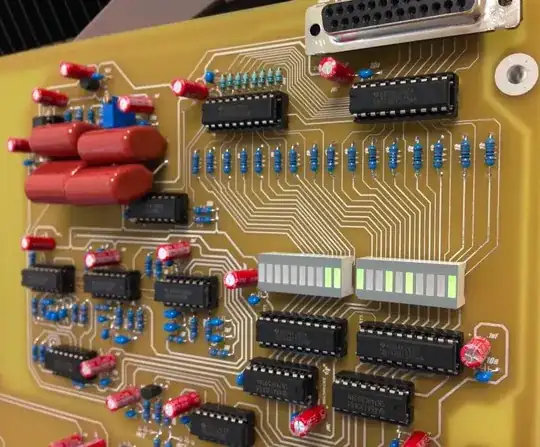

This is more of a conclusion rather than a solution...
I didn't have enough time to design a new circuit using a crystal so I made the PCB with the following changes to try to make it better:

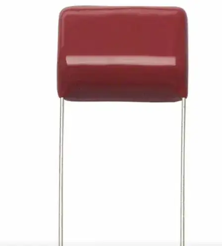

  1. higher precision, temperature stable film caps. I put 2 in parallel in a attempt to make the capacitance more stable. When one capacitor sinks/sources more current it heats up causing it's capacitance to go down... making the other capacitor sink/source more current. So you get some regulation happening. This is NOT always the case with ceramic capacitors which is what i was using before.
  1. higher precision resistors for the RC circuit. I used .1% tolerance rather then 1%. They also had 4x the temperature stability.
  2. 4v voltage regulator for the 555 timer. This isolates the 555 voltage rail from the rest of the digital stuff by a factor of 100 (1% line regulation).
  3. Used 5k pot instead of 20k pot to trim the pulse time. Reduces the error caused by the pot instability.
  4. Buffered output for the 555 timer pulse signal. I used an LT1630 to drive the timing pulse to all the gates so the Timer IC wasn't driving any current. The gate inputs can interact with each other if input drive is not low enough impedance. I got ~7 gate inputs connected to the timing pulse so I wanted to guarantee a strong signal.
Result: I got around ~.04% accuracy (1 bit toggle @ ~2500dec value on bus). For the first circuit I was getting around .5% accuracy (the accuracy I posted originally was wrong) and the value was constantly drifting. The new circuit has no noticeable drift. So in conclusion using better quality components I increased the accuracy by ~10x and made it stable and actually usable.
I know this is not the best or even simplest method for making a frequency counter but its cheap and effective. I'll probably use it again when I need to take a crude frequency measurement.
The value gets read by the DB25 port with 8bits Hi/Lo select. The LEDs are just for debugging. I always add LEDs wherever it can make my life easier.
