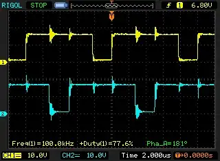

I did some test with:
  1. No capacitor
  2. 1nF capacitor
  3. 10nF capacitor
I added an idea of the schematic of what I'm testing, I'm using SiC MOSFETS, the power stage are two boost converters with common ground.
The driver ground is connected to the power ground of course.
This is what I found:
With no capacitor
1nF capacitor[![][3]]4
10nF capacitor
I think it is highly related to the comments of Marcus Müller and the answer of JonRB.
Further explanation of this is appreciated.
Thanks
