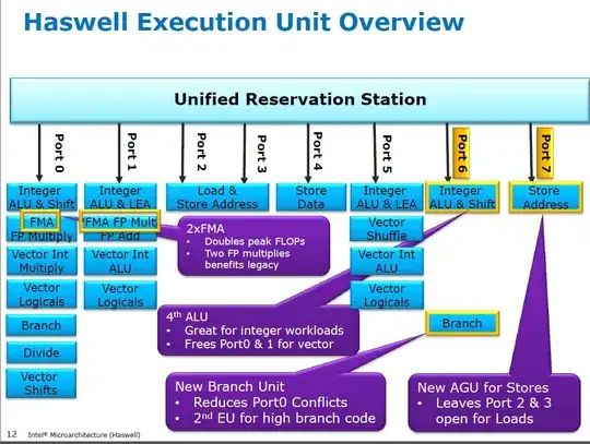

This diagram from Intel may help:
Haswell Execution Unit Overview
It appears they've given each unit a FMA (fused multiply-add) as well as a multiply and a single adder. They may or may not share hardware underneath.
The question of why is a lot harder to answer without internal design rationales, but the text in the purple box gives us a hint with "doubles peak FLOPs": the processor will be targeting a set of benchmarks, derived from actual use cases. FMA is very popular in these since it is the basic unit of matrix multiplication. Bare addition is less popular.
You can, as has been pointed out, use both ports to do addition by with a FMA instruction where the multiplication parameter is 1, computing (A x 1) + B. This will be slightly slower than a bare addition.
