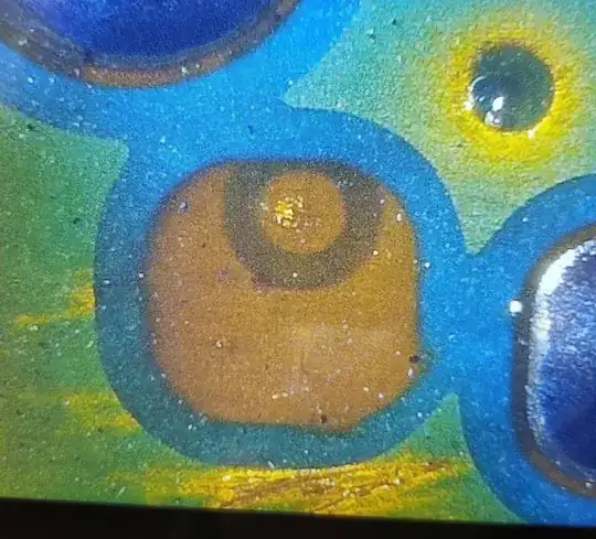

I already tried to cover the broken pad with tin by making a solder bridge between the neighboring ground pads, without success. But after the heating it gave me a better view on the underground of the broken pad. zoom on mounting position of switch
There seems to be an outer and an inner conductive plane, the inner one with an little golden point in it. Is that the via-in-pad? zoom on potential via in pad
I also tried to short the connection by a wire with an alligator clamp on ground on the one side and a multimeter probe on the other side. With the probe I tried to touch the via. I had no success in switching on the phone by this method.
Is the inner circular area with the golden point my target potential which I have to pull on ground?

The ripped pad was not connected to the ground plane, so don’t try connecting it there anymore. The pad is connected to an internal signal trace, or perhaps a trace on the other side of the board, via a plugged via. That’s the little bit of metal inside of the darker ring under the pad. The darker ring is an isolated area to separate the via from the plane immediately under the top side of the board. There may be more of those deeper into the board, but it’s hard to tell.
You could replate it, or find the other end of the via by testing with the multimeter on "bip mode" so you can find where the trace goes, and then solder a small transformer wire to the other end.

You could try to buy a pen with conductive ink if the reason you couldnt solder the via was surface tension. Just put a spot of ink on the pad and it should work, if the via still connects to the top layer.
