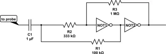

when I wanted an AC water sensor I used a 555 with the probe connected in place of the capacitor. the 555 frequency changes in response to water level.
but you could probably do a similar sort of thing just using microcontroller ports, pull down and time how long it takes the port to change, then pull up etc...
simulate this circuit
this sort of thing but done in software
