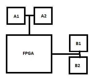

I have a PCB with a FPGA and a 2 banks (2 rank) DDR3 ram setup. Topology
Data errors occur either when the RAM (FPGA is not confirmed, but could be) reaches higher temperatures (40°C) or right from the start and always (out of 20 tested faulty PCBs, the error occured at the same ram) on the 16 Bits which are associated with dqs[1..0], which are the X1 RAMs in each bank.
