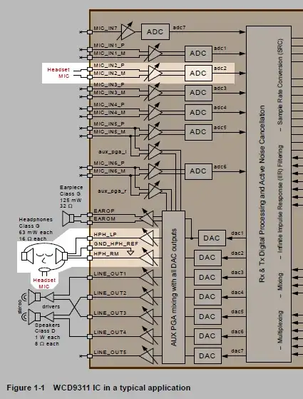

The big IC is of course the WCD9330, as best as I can tell (the manual is missing the part manifest!) The manual doesnʼt show where EAROUT_L, EAROUT_R, HPH_REF, EAR_MIC_P, and EAR_MIC_N go, but Iʼm more or less assuming these go directly (via a separate PCB) to the 3.5mm jack. This seems to be also suggested by the relevant part of the “typical application” diagram of the very similar WCD9311:
Qualcomm WCD9311 Typical Application — Headset Audio
One thing that confuses me, however, is that HPH_REF and EAR_MIC_N are shown as separate lines and even have separate resistors, but in fact the phoneʼs headset uses a TRRS (four conductor) plug, on which the ground ring is shared between the headphones and headset mic.  Hmmmmm. So whatʼs going on, there?
