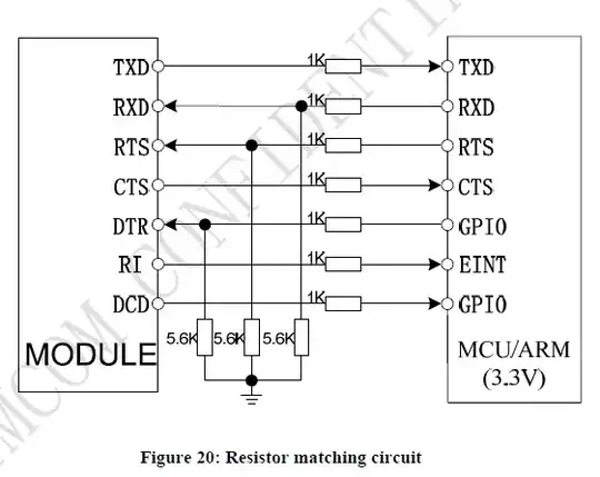

EDIT: I connected the MCU to the GSM module as suggested by the datasheet of the productor for 3.3 interfaces (obviously rx-tx, tx-rx the image is faulty). The only pins involved in my case are transmission and reception and ground and supply, so ignore the rest for the UART protocol.
For what concerns the code there is not so much to speak about, simple transmit and wait for a response in polling or interrupt mode. UART is set in 8N1, as Arduino SoftwareSerial that I successfully used does by default. Peripherals initialization code was automatically generated by CubeMX. Messages are correctly send by the MCU, just by checking with a terminal. Doubting about hardware is my last idea, but in this case I can't see other options for my short experience.

    While electrical concerns to avoid *damage* are indeed important, the issue you face is most likely a *software* problem - you're provided no evidence that you are successfully using the STM32 UART (or at least the correct one with correctly configured pins) to do the same things that the Arduino sketch does. Nor have you documented how you currently have things connected in a way that might show an adjustment needed for lower drive voltage into a divider, or even demonstrated that your program is running at all. – Chris Stratton Jul 24 '19 at 18:40
