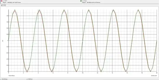

EDIT: Acquired some waveforms for the last circuit:
This one under no load condition Waveform no load
And this with the motor. Measured armature resistance was about 2.2R and inductance about 240uH. Waveform motor

  • @winny added some waveforms for the second circuit just now – bleudoutremer Jul 23 '19 at 13:19
  • Great! Looks like it's fully turning on but please be aware that this is less Vgs than most would dare to design for. – winny Jul 23 '19 at 15:27
