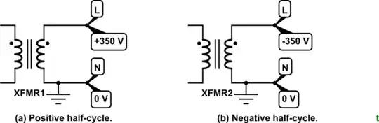

Figure 1. Voltage measurements during positive and negative mains peaks.
The mains voltage peaks at \$ \sqrt 2 \$ times the RMS voltage. For your 250 V RMS supply that will be about 350 V peak. If you had a fast-acting DC meter with max / min peak hold function you would be able to take the readings indicated in Figure 1. Neutral stays at 0 V and the live wire polarity alternates.
If you touch the neutral wire you won't get shocked but if you touch the live the wire you get shocked why and how?
Because the neutral has been neutralised. There is no voltage on it with respect to ground.
