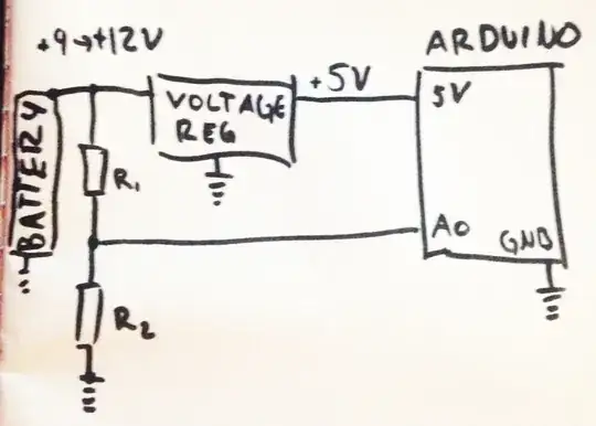

Anyway, the analog input can only accept input voltages between 0 and 5V. So I can't obviously connect the battery directly to this input, this would burn the Arduino. The idea I have is to use a voltage divider like this:
Schematic
And choose R1 and R2 to be 1.5kΩ and 1kΩ. This should give an input to A0 of 4.8V if the battery gives 12V, and and input to A0 of 3.6V if the battery voltage goes down to 9V. It should be enough of a difference in voltage for the analog input to be able to measure it.
Well... That's what I thought anyway... Is this a good way of doing it? Is this the "standard" way to measure battery life, or are there other better methods?

  • What type of 12V battery are you using? – evildemonic Jul 19 '19 at 15:10
    Have you searched for similar questions here? This is quite a regular question that pops up and has been answered a number of times – MCG Jul 19 '19 at 15:11
  • Oh ok... I googled, but didn't search the questions here... Found an answer here: https://electronics.stackexchange.com/questions/24170/how-to-measure-battery-voltage – Mikael Lindqvist Jul 19 '19 at 15:19
  • Possible duplicates: https://electronics.stackexchange.com/q/217962/2028 https://electronics.stackexchange.com/q/122495/2028 https://electronics.stackexchange.com/q/93718/2028 – JYelton Jul 19 '19 at 15:27
  • ... and this one too, possibly: https://electronics.stackexchange.com/a/39429/7036 – Nick Alexeev Jul 22 '19 at 14:20
