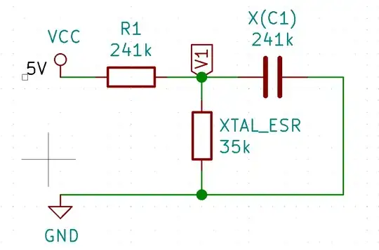

My circuit runs at 5V. With \$R_1\$ and \$X_{C_1}\$ both equal to 242k and the crystal's effective series resistance at 35k, how do I calculate the current through and voltage over the crystal?
This is probably where I go off the rails (if I'm not already), but do I approach this as the following equivalent resistor network?
Where Ohm's law would put the parallel resistance over the crystal and \$X_{C_1}\$ at 31k, the voltage at \$V_1\$ at 0.57V, the current through \$R_1\$ at 18\$ \mu A\$, \$I_{XTAL}\$ at ~\$16 \mu A\$ and by extension the power consumption of the crystal at \$0.57V \cdot 16 \mu A = 9 \mu W\$?
How do I approach calculating appropriate values for \$R_1\$ that satisfy the crystal's specifications?
