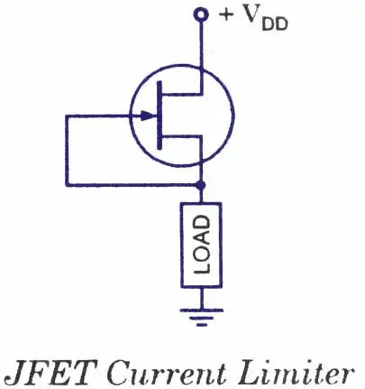

I've found some simple solutions using JFET with bound Gate and Source, but I'm not sure what's the actual current limit level, or even if it's applicable in our project since it's mostly used as constant-current driver for LEDs:
http://www.circuitstoday.com/wp-content/uploads/2009/08/jfet-current-limiter.jpg

Thanks alot for all the anwers! We made some changes to our original design, but your suggestions is really helpful in other cases. This is how we've done:
To keep it both simple and cheap we've changed the overall supply voltage to 24v and implemented a first-stage high-effective switch regulator which brings the voltage to ~14.5V and then we've added a simple linear regulator (LM7812 derivate) for each output stabilising it to 12V and makes each one independent from the others. The linear regulator has short circuit and over current protection built-in.
