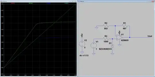

  • I've simulated your first schematic with LTSpice and it works fine if I just ramp the signal from 0V to 5V, but if I add my op amp with the feedback resistors, the output never goes above 4.7V, no matter how high the input. The TL431 ref is always a little below 2.5V, so the mosfets don't trigger. I don't necessarily have to blow a fuse, if I can make the design safe in an easier way. I have a 5V supply that I can't really change currently. If that's not a problem, I'd be grateful to hear your other suggestion. – Eye of Horus Jul 17 '19 at 08:40
