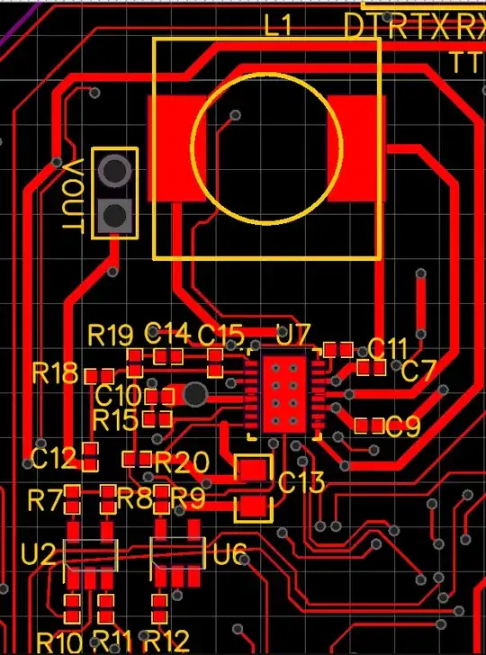

I am currently working on a heated glove project using a Buck-Boost converter to adjust the temperature of the glove. I'm using the LTC3112EDHD#TRPBF QFN Buck-Boost IC to control the Buck-Boost functionality. I just finished soldering my test PCB, and my Buck-Boost Converter IC isn't outputting a voltage. My multi-meter is reading a voltage output of 0V. I've included my schematic design below. The PCB layout is exactly the same as the schematic. Some of the ports on the IC are controlled by a micro-controller.
I honestly do not know what could be the issue with this circuit. My two guesses are that either some of the passive components got damaged during soldering (which I doubt. I confirm the resistors work properly, but can not confirm the capacitors functionality due to my multi-meters limitations), the Buck-Boost IC isn't solder correctly, or my design layout is incorrect. Any help would be greatly appreciated.
Edit: I've added the PCB layout of the schematic. It may be hard to see due to all of the connections, but I've included it as a reference.
PCB Design

    Jay - Welcome :-) You said: "*The PCB layout is exactly the same as the schematic.*" While it may not be related to this question, it's not clear what you mean by the quoted text. The PCB layout requires certain characteristics (e.g. component locations, trace widths etc.) which are not shown in the schematic, and so the layout *cannot be assumed to be valid*, even if matches the schematic. With any SMPS question, it's a good idea to include the PCB layout (e.g. from your EDA software) and some photos of the completed PCB, in the question. – SamGibson Jul 07 '19 at 16:49
  • Where is C10 and C13 located? – winny Jul 07 '19 at 21:03
  • C13 and C10 are in the screenshot. C13 is right below the Buck-Boost, and C10 is to the left of the big via. – Jay Jul 07 '19 at 23:31

  • http://rohmfs.rohm.com/en/products/databook/datasheet/discrete/transistor/bipolar/qs5w2tr-e.pdf Here is the datasheet to the BJT's. In my program, the desired transistor to be turned ON at Vbe is set to logic HIGH while the rest are set to logic LOW. So are you saying because of CE leakage, that can create some issues with the feedback input? – Jay Jul 07 '19 at 12:36
