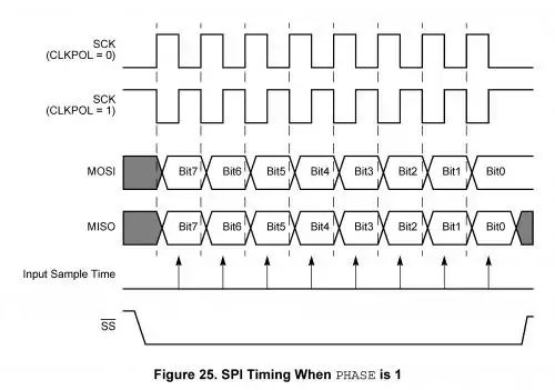

But some microcontrollers don't have the SPI hardware on board and then you have to simulate it by doing everything manually. SPI has a number of different modes, I'll use this pulse diagram as an example:
So while a dedicated SPI controller takes care of all the pulses, data shifting and timing, when bit-banging you have to take every action yourself:
Make Slave Select low
Short delay
Do 8 times
  Make the SCK (Serial Clock) pin low
  Make the MOSI (Master-Out-Slave-In) pin high or low depending on bit 7 of the data
  Add brief delay
  Make the SCK output high
  Read MISO (Master-In-Slave-Out) pin
  Shift received data left, and shift the bit just read in as bit 0
  Add brief delay
  Shift the data byte 1 bit left
Make Slave Select high again

  • @Steven - the diagram you show is MSB first, so you need to left shift out from 7 and left shift in from 0. I know there is no standard so it can be LSB first, but I think most SPI peripherals do it this way. – Oli Glaser Oct 15 '12 at 15:08
    @Oli - good point, I missed that. I'll fix it, thanks for the feedback. The reason there's no standard is that it doesn't matter as long as the number of transferred bits is equal to the shift register length. Recently some microcontrollers (like NXP Cortec-M3) have a variable length shift register, and then direction may matter. IIRC in the AVR you can select MSB first or LSB first. – stevenvh Oct 15 '12 at 15:14
