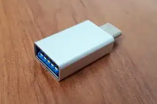

I'm talking about a USB type-C male to USB type-A female adapter, the ones you need to connect a USB flash drive to the latest MacBooks.
USB-C adapter
According to USB-C specification, this sort of adapter needs a 5.1 kΩ pull-down resistor on type-C plug's A5 pin (configuration channel). This is needed, because the host device won't supply power until it detects a connection on CC.
However, I have seen some such adapters boasting a 56 kΩ pull-up resistor, which would be needed for a type-C male to type-A male adapter, but as far as I know, not for the kind I'm talking about in this question. Why would they include this resistor? It was marketed as a safety feature.

Adapters with Type-C male to Type-A female connections advertising a 56 kΩ resistor value are wrong. The resistor tells the Type-C downstream-facing port (DFP) whether the connected device is sourcing or sinking current. The presence of a female Type-A receptacle means that the adapter should use a 5.1 kΩ pull-down resistor to indicate that the device (whatever is plugged into the Type-A receptacle) is going to sink current.

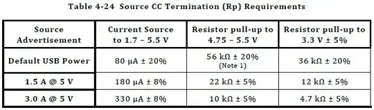

The USB Type-C specifications (available at USB.org as "Universal Serial Bus type-C Cable and Connector Specification") explain different resistor values for determining whether a device is sourcing or sinking current.
Sourcing Table 4-24 (page 235):
Values used for pull-up \$R_p\$:

Page 85 specifically covers USB Type-C to USB 3.1 Standard-A Receptacle assemblies (the adapter shown in the question):
Note 1. Pin A5 (CC) of the USB Type-C plug shall be connected to GND through a resistor \$R_d\$ (5.1 kΩ ± 20%).
