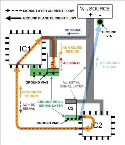

When aVdd and dVdd are shared each with identical low ESR caps will there be circulating currents on impulse logic loads that might be a hundred or a thousand times bigger than the average current.
Meanwhile ripple on Vdd can be suppressed 20dB per decade from the equivalent load resistance, but the avg current * crest factor * cap ESR can still create errors on the Vref or ground return used for ADC and result in more missing codes during the successive approximation after the sample is taken.
Although this IC has some extra benefits of digital filtering, it is still prone to noise at integer multiples of the modulator sampling frequency up to 10kHz, so RF beads do not help.
This means the signal noise is sensitive to harmonics up to 10kHz but the supply and ground depends on the location of your excellent LDO where the ground planes should meet.
See here for an example where the supply is from USB.
USB shield for analog and digital ground?
enter image description here It is wise to isolate both the Vdd and Vss to prevent sharing currents even if they are ideally filtered from the same sources. This requires an understanding of ripple spectrum, split ground planes joined close to the regulator source and use recommended decoupling caps.
  • Thanks for the advice regarding the filtering and the groundplanes. I learned something new here, though It was a bit hard to understand to be honest, as most of the stuff is new to me (especially the shortages). I am not entirely sure what your answer means regarding my original question; does it mean (correct me if I am wrong): I can connect A_VDD and D_VDD but I should decouple them as best as I can using capacitors and remove digital noise using a good layout. – GRASBOCK Jun 28 '19 at 21:45
  • Yes and sometimes this means using a a simulator to determine the attenuation in dB from crosstalk but keeping that path of least impedance away from each load to they source and return to the regulator without shared paths of circulating currents. 24bit sigma Delta is extremely low levels of noise per bit. But you can do a noise margin budget and see what you can afford to lose. – Tony Stewart EE75 Jun 28 '19 at 22:01
