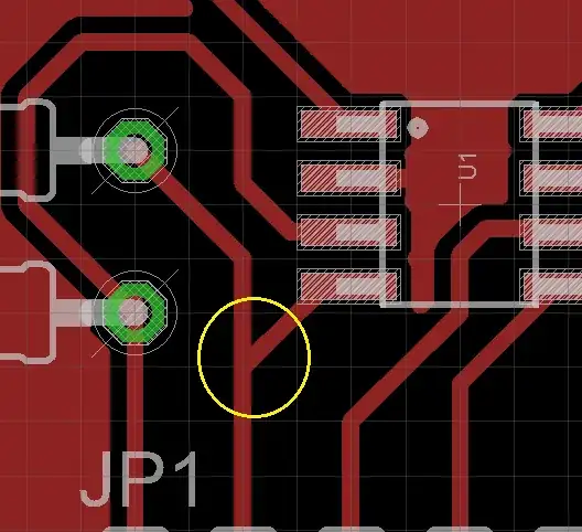

This image contains an example of an acid trap:
Acid trap example.
Image borrowed from this earlier question.
That image also ended up on an AutoCad site as an example of an acid trap.
That yellow circled junction can cause etchant to collect. That will cause too much copper to be removed - this can cause an open circuit if it etches through the trace.
The trap is formed by the acute (less than 90 degree) angle.
As this other question and answers explain, this shouldn't be a problem with modern PCB fabricators.
If you make PCBs your self, then it can still be a problem. You can't use the techniques at home that the fabs use - it takes chemicals and equipment that you won't have at home. For "home made" PCBs, you'll want to avoid 90 degree and sharper angles so that you don't get acid traps.
Besides trapping etchant, I've also had sharp corners trap a bubble and block etchant. That caused a short circuit.
Since acid traps can also form on 90 degree angles, you will often see right angle bends that are made of two 45 degree bends.
