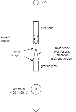

I am experimenting with electrospray ionization. The setup has a 4kV power supply connected to an electrode that is separated from a return lug (or ground plate) via an air gap, followed by an inline pico-ammeter and finally ground. The way this works is that a small drop of solvent is applied to the electrode, the 4kV power supply is energized, and the solvent forms an aerosol electrospray "Taylor cone" between the electrode and return lug. When this is occurring (it is not especially visible except via laser light) the inline pico-ammeter reads somewhere on the order of 20-100 nA resulting from the ion transfer.
I would like to test a very large number of electrodes by systematically switching the pico-ammeter & ground between the various return lugs. My first thought was to use a multiplexer, but I'm not sure if this is even possible, and I have a few concerns. Specifically, iIs there a mux that can switch a ground reference (through the pico-ammeter) to an open (high impedance) circuit, and has a low enough on resistance as to not substantially effect the 20nA ion transfer current?
Also, every so often the air gap gets a little too small and turns into a 4kV "spark gap" which results in having to change a fuse in the pico-ammeter. What would be the best practices with regards to circuit protection for preventing this scenario from frying the switching circuitry?

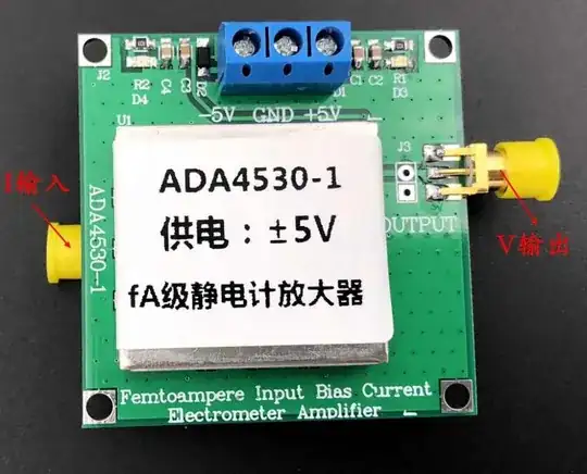

You need a shunt and a very low bias input current opamp, like elctrometer ADA4350 with femto ampere bias. Then you amplify this small signal to your needs. Of course you would need to calibrate for yourself and it won't be such precise as already made pico ampermeter from reputable manufacturer, but it can be cheap enough to build it.
You can also buy from china a module to play with it, just to try. Unfortunatelly it is configured as transimpedance amplifier, while in your case a buffer is needed: enter image description here

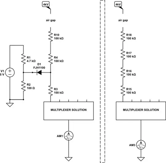

To protect the current measuring system (when it needed to be grounded), I first thought of a clamping circuit as shown below to the left.
But then, I realised there is a way easier circuit, as shown to the right.
The right circuit consist of a few resistors (I only drew R15 ... R18) that are rated sufficiently to prevent break down and limit the current in case the air gap is short circuited (worst condition). With 400kohm, the current is limited to 10 mA, protecting the multiplexer solution and the current measuring system.
Because the resistors are in series with the multiplexer solution and the current measuring system, there is no leakage current.
I kept the left circuit in case it might hint towards other solutions.
In the left circuit the cathode of the ultra low leakage diode D1 is biased at a voltage of 104 mV. When the current is "somewhere on the order of 20-100 nA", due to R3(1) the voltage at the anode of D1 will be max 10 mV. So, D1 is reversed biased and will leak only a few pA.
When the current increases past the about 6 uA, D1 will start conduction and it will clamp the voltage at its anode. The clamped voltage depends on R4...R10, D1 and R2. The max current is limited by R4...R10(2). For the FJH1100, \$V_{F,max}\$ = 1.07 V at \$I_{F}\$ = 50 mA, so, the clamped voltage with be about 2 V + 1.07 V = 3.07 V.
Of course, R4...R10 should be rated sufficiently to prevent break down of each resistor.
(1) The resistance of the multiplexer and current measuring system are assumed negligible compared to R3.
(2) This is where I realised the circuit could be made way easier.
