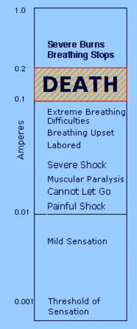

This diagram is helpful:

  • Thank you for taking your time and answering in a detailed way. I didn't necessarily mean being killed by having contact with a frayed cable as, well I'm still alive:) I was just worried about any long term effect... There is just something that I don't understand. On my charger it's written ( output: 5.0V=2700mA/9.0V=1800mA/12.0V=1350mA ) isn't it just too much? According to Google and your diagram 0.2 mA can be deadly... And I do want to buy another cable but the thing is in my country at least 95% of cables are fake, yet they are sold as original. – Draku Jun 21 '19 at 16:26
  • @Draku The current rating of the charger is irrelevant. The voltage however is important. In the case your cellphone it is unlikely that the charger negotiates 9 or 12V since the cellphone is a single LiPo cell. If however you were attached to a tablet or laptop that negotiated a higher voltage ….then this higher voltage would impact how much current flowed through a person. Higher voltage ...higher current. Fake cables being a problem is a separate issue. – Jack Creasey Jun 21 '19 at 18:29
  • Ok I think I understand by now. Even if I got electrified, the flow would be 5 (Voltage) ÷ 100000 ( the skin resistance ) = 0.00005A or 0.05 mA witch is almost nothing I guess. – Draku Jun 22 '19 at 06:51
