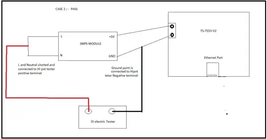

We also tested CASE 2:- where we apply high voltage up to 3kV AC for 1 min between power wire and Secondary Ground. after test unit was ok, no failure observed in this case. (see below case 2 setup image) enter image description here
Question is when SMPS is rated till 3.75kVAC and test pass with CASE 2 setup than why its failure on CASE 1? Is it because of Ethernet transformer or something else? Where is it getting its path from?

  • we have only High voltage tester , where minimum current setting is 50mA. also there is no Y caps in the system (we removed it already before test). there is only one cap inside the SMPS module( yes I open the SMPS module) has 1nF 1KV between Neutral and Secondary Ground. so at 3KV we can except =3KV/(2*pi*50*1nf) =666uA RMS leakage current. But is case 1, I saw one more cap of 0.1uf (10/100 megajack connector shown above) , is connected between ground and Ethernet transformer center tap. So at 1.8KV leakage wil be = 40mA RMS, may be due this Ethernet failed. – Bharav Jun 22 '19 at 04:22
