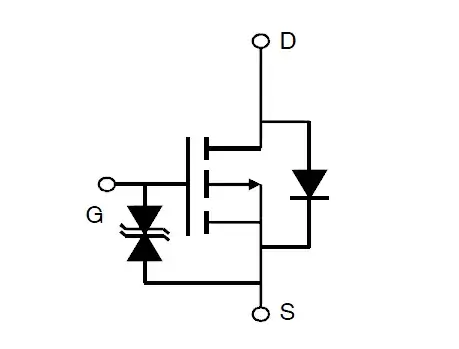

My plan is to start a motor, then stop the motor when the gear teeth gets to 15 (out of 16) I will be able to tell at what position the gear is by placing an IR reflective sensor under the teeth. The sensor is a VCNT2020. I am controlling the motor with three MOSFETs in the schematic here (Leaving out M1): Mosfet Schem
And using the VCNT2020 Sensor in the schematic here: VCNT2020 Schematic
