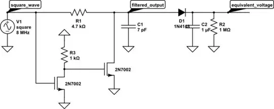

  • See [square wave to sawtooth](https://electronics.stackexchange.com/a/433890/38098). The square wave itself is relatively easy to generate, these days. So the driver for the circuit is relatively trivial. However, it doesn't generate a voltage that peaks at the supply rail. So keep that in mind. (Also, our definitions of what's a sawtooth and what's a triangle wave may be at odds.) – jonk Jun 18 '19 at 15:58

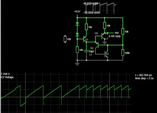

I see your problems. Do I need a diagram to explain?
Your random level and frequency shift are due to a PNP Emitter follower not shown in your schematic which causes Vbc forward conduction from the negative voltage on C1. Because it (Q4 not shown) see almost -0.6V it is on the verge of conduction results in the consequences of your waveform.
Clamping that with a Schottky diode would compromise your amplitude.
So what do you do?
  • don't add a series R to invisible Q4 because Q1-c is a current source and that leakage will cause overshoot on the return stroke if you care(?). So it must be equal to or greater than the Early effect leakage resistance of Q1 for a pristine sawtooth. (which I won't bother to explain may be around >=100k) But maybe you don't need to clamp overshoot.
So change that invisible Q4 (and don't hide things from us again) to an Nch Enh.FET common source or a P ch Common Source. That will give you >5Vpp signal and the level shift will be determined by the Vgs(th) which unfortunately is very loose so that is not a great solution. ( there are many better solutions, but I tried to explain how to fix your signal integrity, not meet some undefined voltage and risetime specs.) Pch Vgs(th)=4V should give you 0.5 to 6V negative ramp sawtooth.
But you really ought to reconsider re-inventing the wheel, define your specs ( which all good designers do in their head or on paper) and then realize what is better, make or buy!! I do not see in either of your two similar questions any specs other than as big as possible at least 21kHz ( a nice VLF Navy channel)
My solution using transistors with fast recovery time.
My Mods
  • I now get a full rail to rail sawtooth to 8.2V by changing the resistor ratio to 10k:100K for the trigger to raise the trigger voltage.
  • I changed R bias Current source to a simple CC source with 2 diodes.
  • With lower bias currents I now had to reduce C to get 100kHz , but this is adjustable with the CC emitter bias resistor such that Ic= 0.35V/Re( 10k)
  • The voltage drop is not 0.7 but 0.35V, because I am only using Ic=35uA whereas you were using 4.5V or so.
Your problem
  • with no resistor on Q4-b and CB becoming forward biased. ( which I had to imagine that you had, even if it was obvious to some)
  • p.s. I did not watch the video link. Did I miss anything better? – Tony Stewart EE75 Jun 18 '19 at 16:28
  • Falstad's javascript simulation. http://tinyurl.com/y2pu89q5 – Tony Stewart EE75 Jun 18 '19 at 19:02
  • Thank you for explaining me what's wrong with my circuit! How you writed make things easier to understand. You did not miss much from the video as you already understood how the circuit is working. I did not have an invisible Q4 as you said but a follower, it allowed me to connect my signal to a comparator, otherwise my signal went to 0. I'm trying to simulate your circuit as i allow me to have a rail to rail sawtooth which is better for me but the output i can't output the signal. It's the same as the one on falstad. Do you think it's the software simetrix not working ? – Gragon Jun 19 '19 at 08:31
