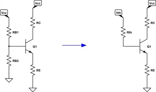

If you think closely about your circuit, you'll see the following as true:
simulate this circuit
Just applying KVL now, we can find:
$$V_\text{TH}-I_\text{B}\cdot R_\text{TH}-V_\text{BE}-I_\text{E}\cdot R_\text{E}=0\:\text{V}$$
But as \$I_\text{B}=\frac{I_\text{E}}{\beta+1}\$, this can be re-written as:
$$V_\text{TH}-\frac{I_\text{E}}{\beta+1}\cdot R_\text{TH}-V_\text{BE}-I_\text{E}\cdot R_\text{E}=0\:\text{V}$$
And solved for \$I_\text{E}\$ as:
$$I_\text{E}=\frac{V_\text{TH}-V_\text{BE}}{R_\text{E}+\frac{R_\text{TH}}{\beta+1}}$$
Or, alternately, for \$I_\text{B}\$ as:
$$I_\text{B}=\frac{V_\text{TH}-V_\text{BE}}{R_\text{TH}+\left(\beta+1\right)\cdot R_\text{E}}$$
The above assumes that the BJT is in active mode and isn't saturated by the circuit that surrounds it. (But this is easy to test. If you compute \$V_\text{C}=V_\text{CC}-\beta\cdot I_\text{B}\cdot R_\text{C}\lt V_\text{B}\$ then it is in some level of saturation.)
