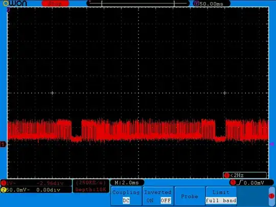

Here's one of the RGB signals, measured on the AD725 pin after decoupling capacitor. There's DC bias of about 3V before the cap. enter image description here

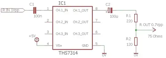

Many triple video buffer ICs are available. These generally have a voltage gain of +2 to compensate for loss in the external output resistor when terminated. One example is the THS7314, which can handle up to 1.4Vpp on each input. 1V in produces 2V out. To divide this down to 0.7V you need a divider ratio of 2.0/0.7 = 2.86, so in the circuit below R1 should be (2.86-1) = 1.86*R2. The output impedance of the divider is R1 || R2, which is 1/(1/R1+1/R2) = 1/(1/1.86+1/1) = 0.65*R2. Therefore R2 = Zout/0.65.
The AD725 has high input impedance so the exact output impedance of the divider is not important, it just needs to be low enough for the DC restore clamps to work properly. If you choose the recommended 75Ω then R2 is 75/0.65 = 115Ω and R1 is 115*1.86 = 214Ω. The closest E24 values (5% tolerance) are 120Ω and 220Ω.
In your related question the composite images do appear to be overdriven, so reducing the levels may help.

  • AD725 sets DC bias for its inputs (and that's why 0.1 uF capacitors are put in there), your circuit will change this bias. There must be cap between divider and R/G/B pin, but I caught the issue: resistors in divider + series capacitor on the pin form RC network, they start oscillating and this oscillation flows into the luma output (at least - I am currently experimenting with luma), screen has annoying (moving) vertical lines. Furthermore, touching these resistors with hand (adding even small R/L/C into the network) causes image to corrupt even more. – Anonymous Jun 19 '19 at 19:48
  • This circuit merely buffers and scales the signal. You should still include the 0.1uF coupling capacitors on the inputs to the AD725. – Bruce Abbott Jun 20 '19 at 00:19
