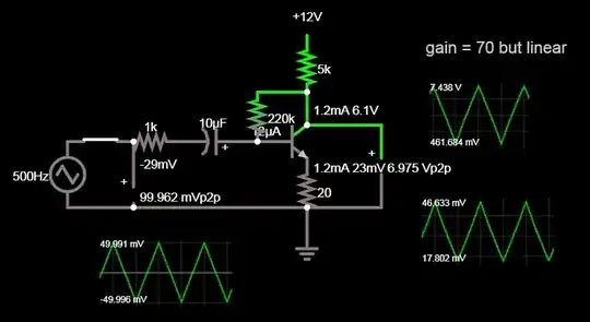

Your understanding of the Rbe is correct and the emitter R increases Rin to Re*hFE and thus reduces the exponential input voltage effects by making the input impedance more constant.
With V(Re) = 1.5V this reduces the nonlinear transformation of input voltage to emitter current and thus reduces sine distortion significantly. But is overkill for a 12V supply with high gain. It’s a poor choice. It only needs to be greater than your Vin pp signal with some margin. In my final example with collector feedback for self-bias, the emitter voltage is very low (30mV) with high gain (70) and very linear!!
e.g. My Sim using Falstad site enter image description here
Re also reduces the gain which is increased when approaching Rbe <50 Ohms @ 1mA and may be neglected if Re =1k. Rbe is controlled by base current. Voltage gain becomes Rc/Re and Vce is biased to mid-scale for large swings by the base voltage-controlled emitter current.
However, if you look at the schematic in your link labelled “Single Stage Common Emitter Amplifier” you will see a design flaw where the collector R is 5k and the load is AC coupled to 1k. When this is smaller, (1/5) all of the DC current bias when modulated by the input can be coupled to the 1k load with only 1/6th the voltage, so the gain reduces horribly and gets collector can get starved of current. Proof of gain reduction
So remember to never load the collector with a smaller R than Rc when AC coupled.
