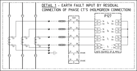

Residual or "Holmgreen" connection of the A, B, and C phase CT's.
This physically implements the calculation IN = IA + IB + IC using the CT wiring.
Advantage: Cheap. No additional CT's are required.
Disadvantages:
  • The phase CT's are subject to manufacturing tolerances, so that the summated current IN = IA + IB + IC may be different to the true neutral current. This limits the sensitivity of earth fault protection using such CT's.
    When using class 10P protection CT's (an IEC CT class accurate to 10% at the accuracy limit current), a typical earth fault pickup setting would be 10% of CT nominal current. Lower settings are possible but may lead to nuisance tripping.
  • The phase CT's must be selected with a ratio to suit the normal load current on the circuit. Where the system is impedance earthed (i.e. neutral earthing resistor or earthing transformer), the prospective earth fault current may be quite small. This leads to situations where the rated current of the phase CT's is too high to detect the prospective earth fault current.
    Consider an 11 kV system with 25,000 A three-phase fault current, which has a neutral earthing resistor limiting the maximum earth fault current to 100 A. It is desired to protect a 12.5 MVA 11/3.3kV transformer (11kV FLC = 660A or so.) Phase CT's of 800/1A ratio would be supplied. The best earth fault protection setting possible would be 10% × 800 A = 80 A, which is barely adequate given the maximum earth fault current of 100 A.
Software summation of the A, B, and C phase current measurements.
This is exactly the same as the residual connection of CT's, except it is implemented in software.
The Areva/Alstom/Schneider MiCOM series of relays, offers both a) a physical CT input for connection of a neutral CT or residual CT connection, and b) a software IN = IA + IB + IC "derived" element.
Both are available for separate or simultaneous use.
The advantages and disadvantages are the same as when the CT's are residually wired physically - CT mismatch and CT ratios too large to provide adequate earth fault sensitivity.
