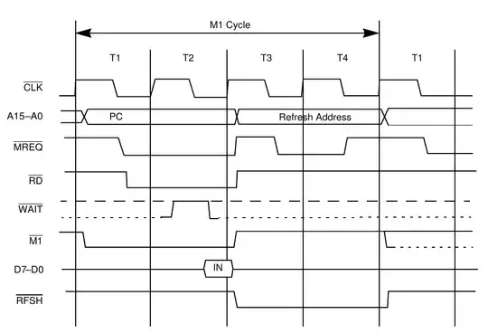

Nevertheless, the Z80 performs a memory reading for DRAM refresh immediately after the opcode fetch. This time, RD is HIGH despite it's a read operation, causing the buffer to flip its direction and drive the bus, the result is a bus contention. So weird "notches" would always appear during the DRAM refresh cycle, but not ordinary memory reads/writes or I/O. This explains why the "notch" would always appear, but only for some, and not all logical 1s.
Z80 opcode fetch timing diagram
Furthermore, SRAM doesn't need to be refreshed so the DRAM refresh is completely useless in my system, and this bus contention would not corrupt any instructions or data, making the system appears to be fully functional.
Solution: implement (RD AND REFRESH) and (NOT (RD AND REFRESH). In the next revision, I should also test BUSACK to make sure the data buffer is not driving the bus during a DMA operation as well.
