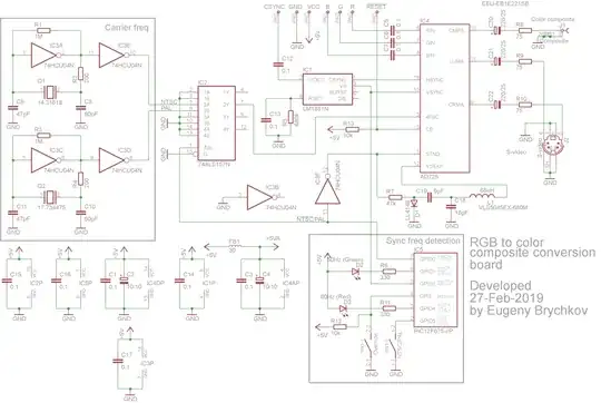

Update 3: here's circuit diagram.

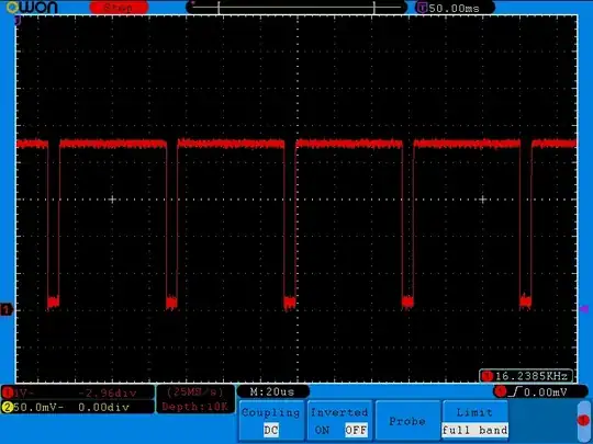

The width of the HSYNC signal was 6 us, out of spec of 2.8 ... 5.3 us for AD725.

  • _The board based on AD725 has logic to switch to PAL in case it detects vertical sync of 50 Hz_ What are you using to generate the sync? If you can post a schematic, that would be helpful. – Batperson Jun 07 '19 at 01:49
The mother circuit had the location to source this signal (as video processor outputs 4.7 max, and prolongation of the pulse was introduced down the circuit), and I reused this signal.
