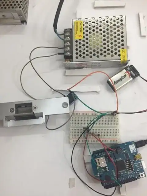

Actually, I want to measure the AC current using ACS712 connect with ESP32 module. I know this module only works under 3.3v. So, I used voltage divider circuit and step down 5v to 3.3v which is being come from the acs712 20A (You may consider any of your 5A/20A/30A chip). I also tested the "ACS712.h" Arduino library. Still, I do not get proper current which I compared with 2 multimeters. Maybe I need to change in hardware side means place op. amp in between circuit. So, Help me to resolve my issue. Thank's in advance.

  • Bruce i tested multiple load and got error around 0.50 Amp. I measure inductive load. Without load it shows nearer value. With load condition multi meter shows exp. increasing value means conti. increase where this acs712 can't show that kind of variation. I know Esp32 not to much faster (consideration due to some delay for adc measurement). But still it shows nominal changes. – jems Jun 11 '19 at 06:42

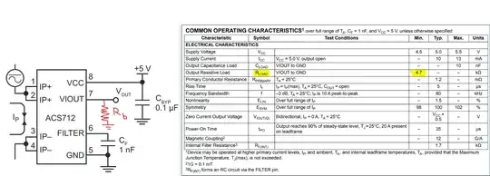

As mentioned, you've used a resistor divider (R1 and R2) to level down the voltage, but did you check the datasheet for the burden resistor? So the resistor divider between Vout and the ground should have an equivalent resistance greater than or equal to the burden resistor
( R1 + R2 ≥ Rb )
I don't know why they have not mentioned the resistor in the typical application diagram.

  • I used a resistor which less than Rb. I clarify I want to get the proper output of ACS712 AC current. It is not related to the voltage regulation circuit. Divyam how to add a buffer between a micro controller and o/p resistor.pls share at least any reference circuit. – jems Jun 10 '19 at 04:07
  • yeah i added the buffer with negative feedback, but its just a basic example, in the schematic the OP07 is just shown as it is available in LTSpice by default, before using an op-amp as buffer do checkout its datasheet to look for bandwidth, slew rate, etc....according to your needs. – divyam Jun 10 '19 at 13:55
