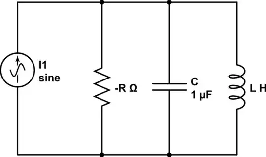

Here is what I imagine the circuit symbol would look like: ckt symbol
