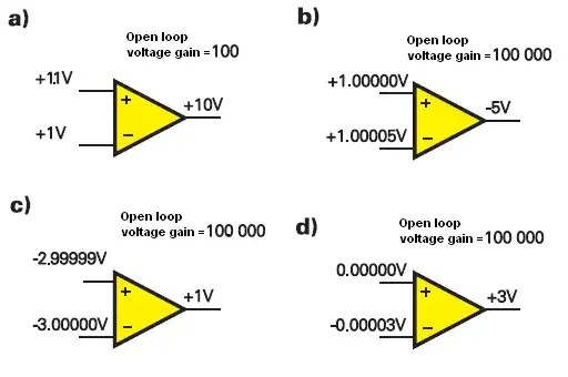

You are right, in real life, the op-amp alone (without any feedback loop) is nothing more than a differential amplifier. The output voltage is the difference between the \$+\$ and \$-\$ inputs multiplied by the open-loop gain (Aol):
\$ V_{OUT} = (V_+ − V_−)*A_{OL} \$
Also, you must remember that the op-amp open loop gain is very large; therefore very small change between the input voltage will cause a large change at the output (Fig. b, c, and d).
The voltage difference at the input must be equal to:
\$V_+ - V_− = \frac{Vout}{A_{OL}} = \frac{3V}{100\: 000} = 30\mu V\$ (Fig. d)
As you can see this difference is indeed very small. Hence, we can say without much of an error that \$V_+ \approx V_−\$ when op-amp is working in a linear region (negative feedback applied around the op-amp) and when the open loop gain is very high.
Additionally in circuit theory we analyze the circuit assuming that we have an ideal opamp. And one of the properties of an ideal op-amp is that it has infinity large open loop gain. Try to think about it for a while. And I hope that now you see why \$V_+ = V_−\$ is true for the ideal op-amp case (infinite open-loop gain).
