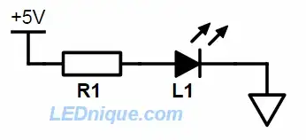

12
Instead of saying the consumer (circuit) draws as much as it needs, it is better to say current will flow as much as is allowed by the circuit.
How much current a circuit will allow is based on its resistance (or impedance). An LED has a voltage drop, but very little resistance. This small resistance means that more current will flow through it than is healthy.
A resistor is an easy and common way to limit this current. There are many many examples on this site alone on how to do that. Search for "LED current limiting".
To get you started, use Ohm's Law to calculate the resistor you want:
Subtract the LED's voltage drop from your source voltage. This is how much voltage you need to drop across your resistor. Now use the amount of current you want to pass through your LED to calculate (using Ohm's Law) the size of resistor that will do this.

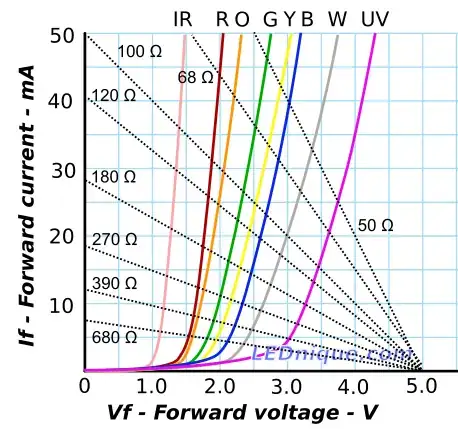

Figure 1. The I versus V curves for a range of typical LEDs shows that the forward voltage of an IR LED is about 1.25 V at 20 mA. Source: LED IV curves.*
Note that if you were to apply even 2 V to the IR LED that the current would exceed 100 mA and it might not last long. At 5 V a bare IR LED would almost certain die instantaneously.

Figure 2. A loadline graphic calculator for various LEDs on a 5 V supply. Source: Loadline resistance graphic tool.
To use the tool:
  • Select your LED colour: IR in your case.
  • Select the current you want: 15 mA in your case.
  • On the If axis move up to the 15 mA line and move across to the IR curve.
  • Select the nearest loadline curve: 270 Ω.
A 270 Ω resistor will limit the current through your IR LED to about 15 mA on a 5 V supply. There will be 1.25 V across your LED and about 3.75 V across your 270 Ω resistor.
