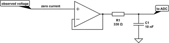

Adding a voltage follower is also an excellent opportunity to also add an RC low pass filter, if your signal including noise isn't inherently band-limited to below Nyquist frequency anyway. Your noise has (near) infinite bandwidth, but your ADC is only meant to observe \$f_\text{Ny}=\frac{f_\text{sample}}2=50\,\text{kHz}\$ of bandwidth! So, filtering out anything above 50 kHz will lead to less noise being aliased into the 50 kHz it observes:
simulate this circuit
The ADC will of course load the voltage divider that RC low pass filter is, but at the low impedance of R1 and the sufficient drive strength of about any opamp, this should be negligible. Upon closer consideration, you'll notice that C1 now smooths out the noise to begin with, so you can then reduce the sampling time (if there's any other reason to do so, for example, need for higher sampling rate because of clocking reasons in the MCU).
